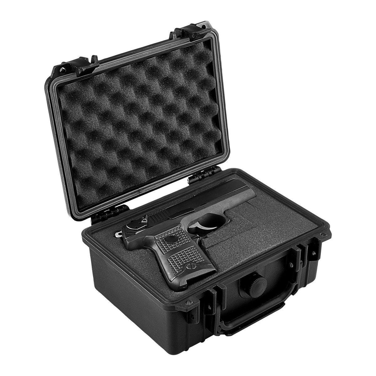

Picked up a another box, this time from Harbor Freight. It was only $13. Could have used 20% coupon to get it down to $10, but bought some wrenches and used the coupon there. I bought in store so I didn’t have to pay the $6 shipping. The box is a little smaller than the seahorse Tiny module boxes I used in the videos, but it was big enough for my remote, antenna, wire, and keys. I really liked the pick foam on these cases since they have three layers of pick foam so you can customize the depth a lot better than the seahorse boxes that only had one layer. They did have several different sizes of boxes in stock at my store. I definitely recommend these boxes if you are in the market for one.
